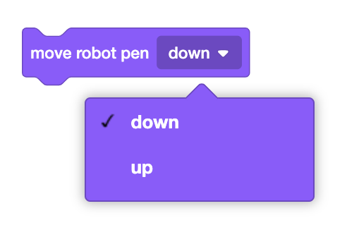

The [move robot pen] block moves the Pen tool up and down on the VR Robot. This example will have the VR Robot draw a square on the Art Canvas Playground.
black square
  • Drag in the [move robot pen] block and attach it beneath the [When started] block.
    move pen down
    For Your Information
    The [move robot pen] block can be used to pick up and put down the Pen tool on a VR Robot.
    set pen position
