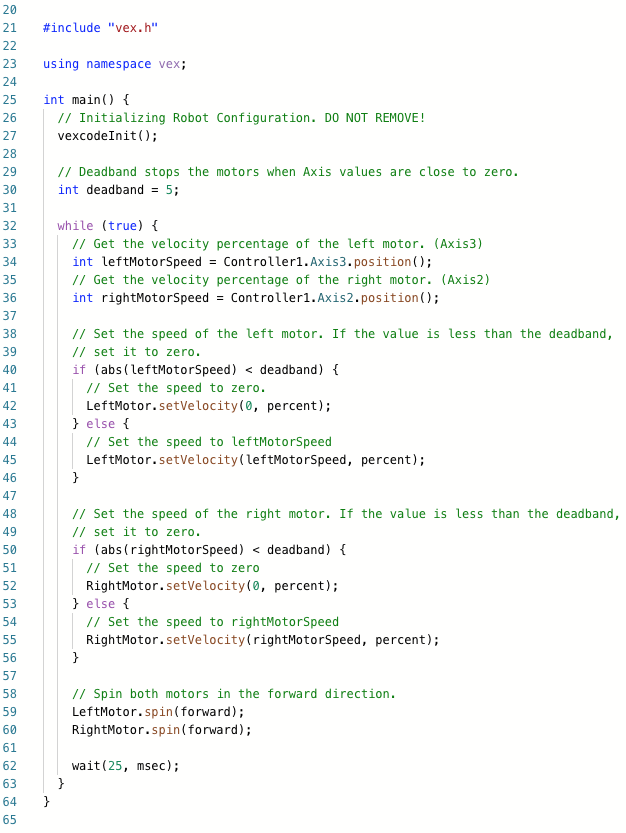

  • Start by watching the Using Loops tutorial video.
  • Open the Tank Drive example project.
    Do the following in your engineering notebook:
    Predict what the project will have the Clawbot do. Explain more than the fact that the project utilizes the Controller.
    How do the joysticks move the robot? What is the Clawbot doing?
  • Save, download, and run(C++ or Python) the Tank Drive example project.
  • For help check out the VEX Library sections on C++ or Python, see the tutorial in VEXcode V5 that explains how to Download and Run a Project.
  • Check your explanations of the project in your engineering notebook and add notes to correct them as needed.

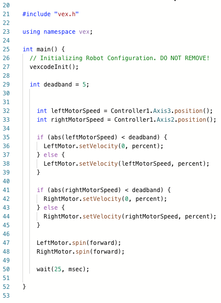

What are the benefits of using the [forever] structure?
Here is our project without the [forever] structure:
What do you think would happen if this program were run? Discuss as a group. Write down your prediction in the engineering notebook.
