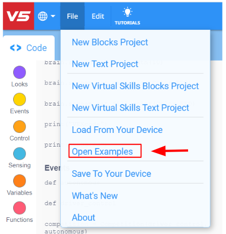

  • Select File and Open Examples.
Open Example
