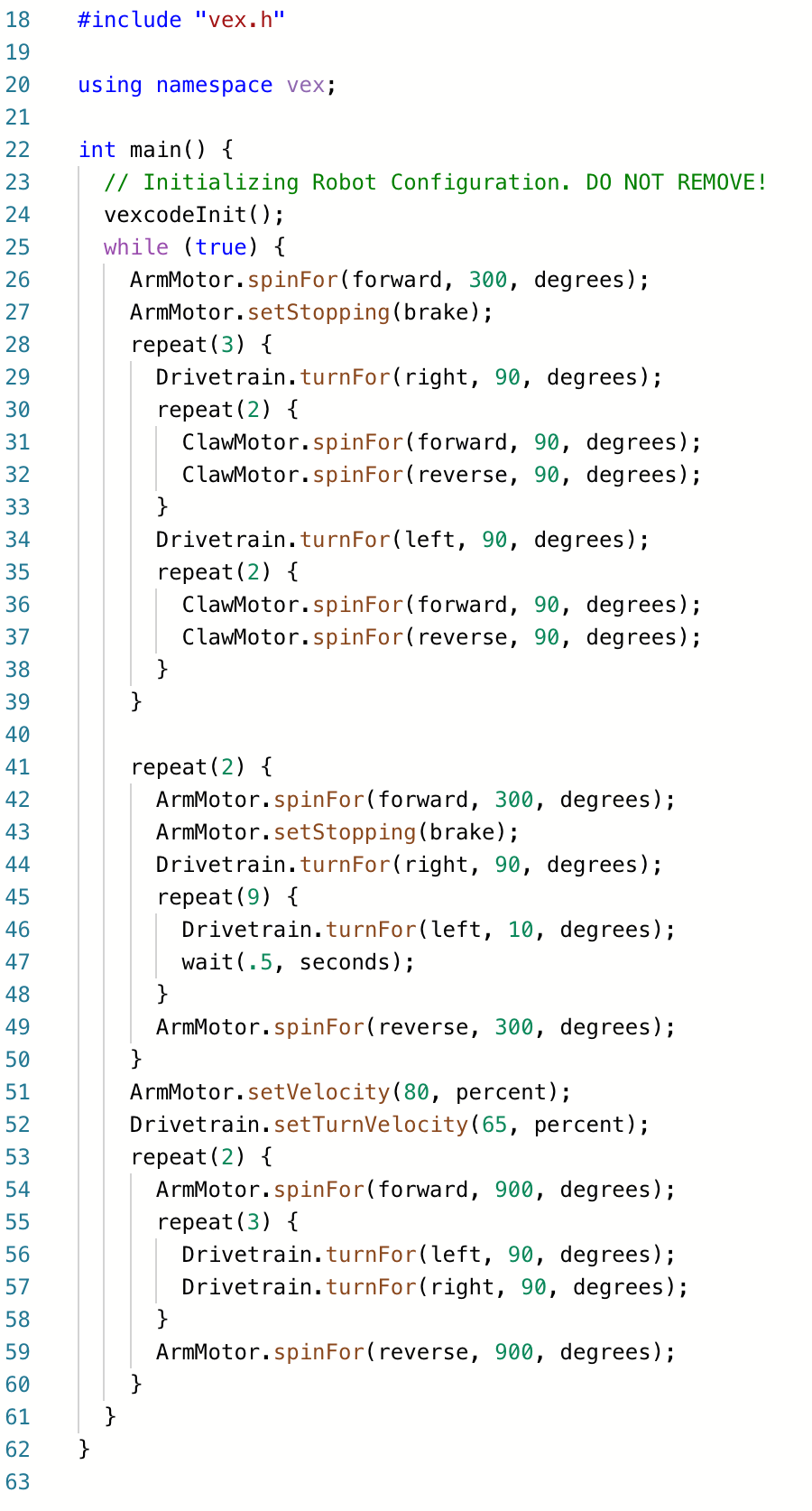

The solution below is merely a combination of all three example dance moves strung together.
