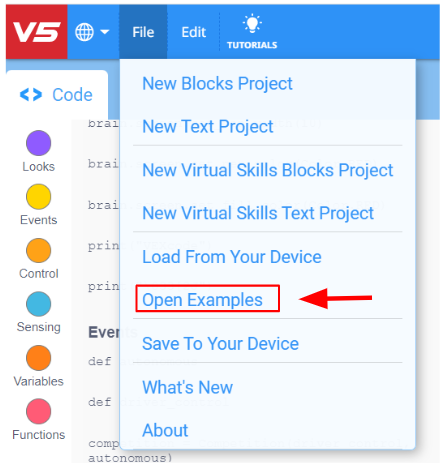

Open Examples
Complete the following steps:
  • Open the File menu.
  • Select Open Examples.
  • Select and open the Clawbot Template (Drivetrain 2-motor, No Gyro) example project.
