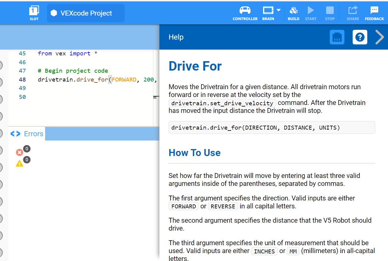

During this exploration you can access help right in the VEXcode V5 program.
Teacher Tips icon Teacher Tips
If this is the student’s first time using VEXcode V5, they can reference the Tutorials at any time during this exploration. The Tutorials are located in the toolbar.
