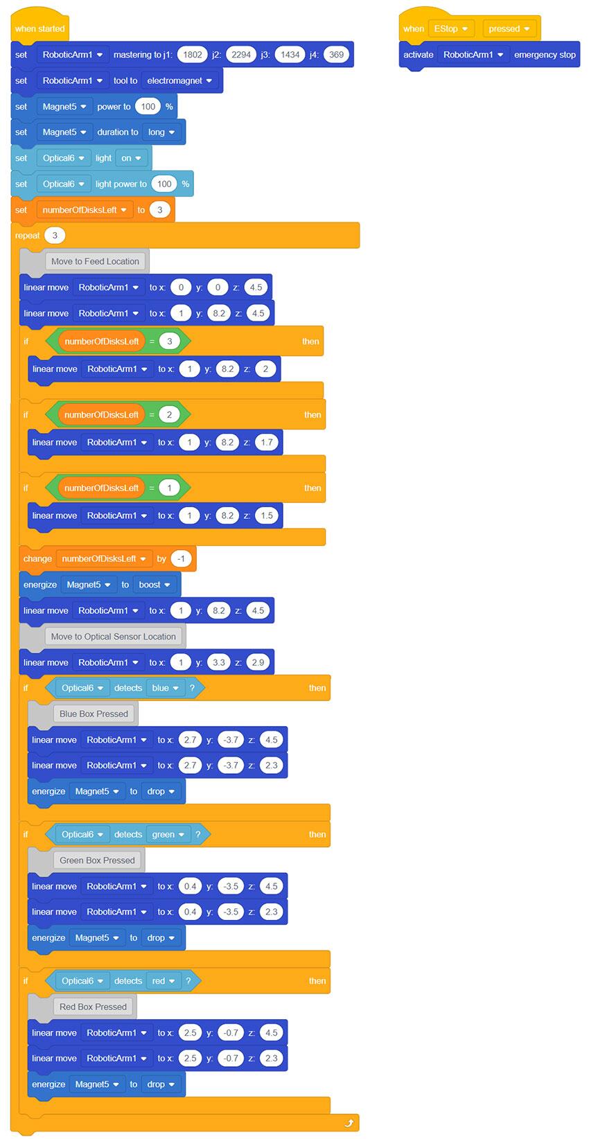

The following is an example of one possible solution for the Rethink challenge. Click here to see a larger version of the example program.
Lab 8 Rethink Solution
