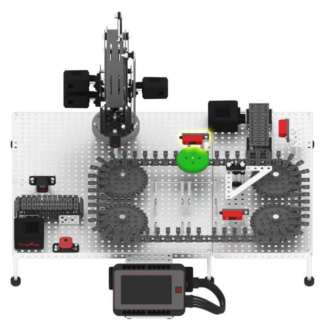

The green disk, acting as an acceptable package or product, will begin at the Entry Conveyor, travel through the Transport Conveyor, pass the Diverter to continue on the Transport Conveyor, and then stop at the Exit Sensor.
The green disk will pass in front of the Load Sensor.
The green disk, acting as an acceptable package or product, will begin at the Entry Conveyor and then move onto the Transport Conveyor.

    Once the green disk is loaded onto the Transport Conveyor, it will pass in front of the Load Sensor. When the green disk passes in front of the Load Sensor, the Diverter needs to be set to position in order to allow the green disk to pass through on the Transport Conveyor.
