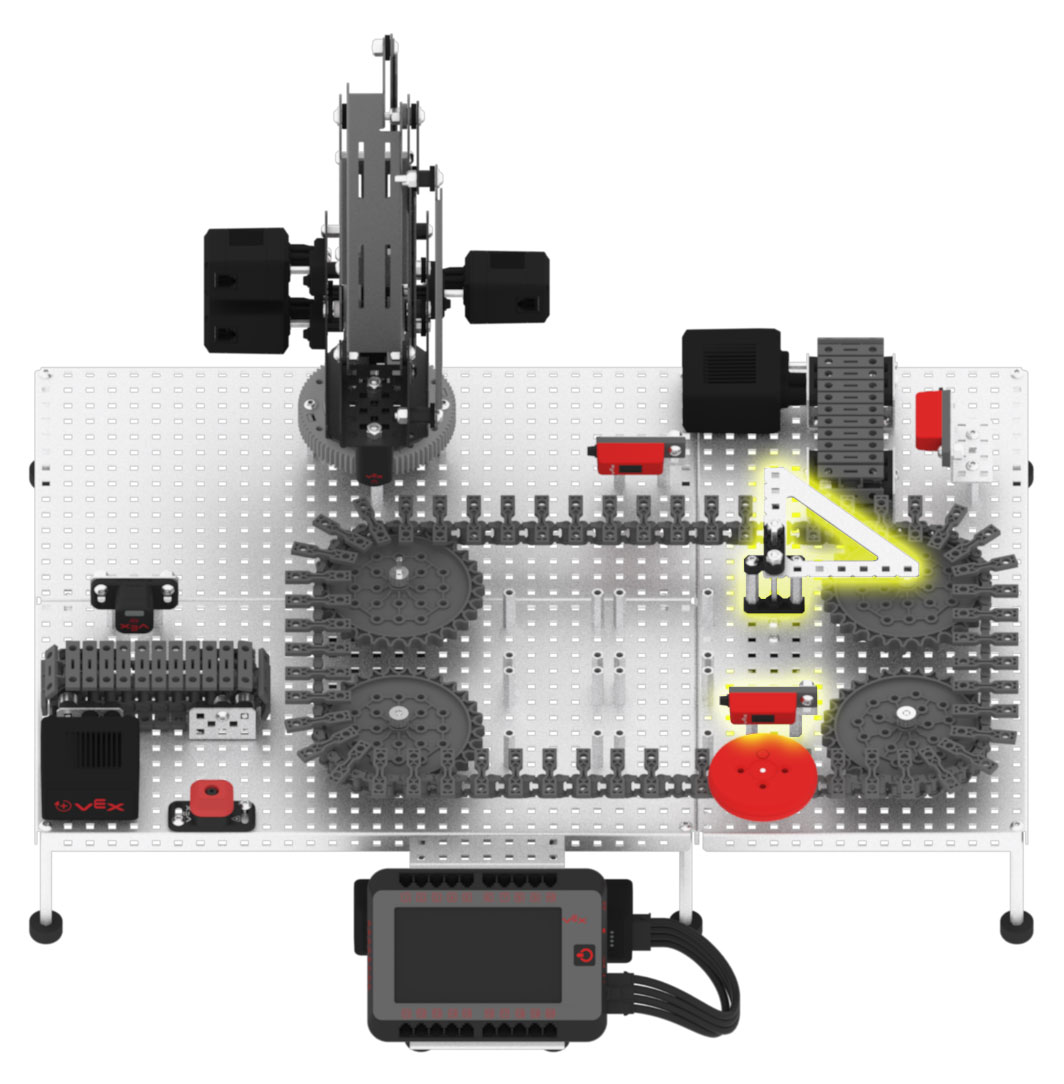

    Once the red disk is loaded onto the Transport Conveyor, it will pass in front of the Load Sensor. When the red disk passes in front of the Load Sensor, the Diverter needs to be set to position in order to divert the red disk to the Exit Conveyor.
    The red disk will pass in front of the Load Sensor.
  2. Add another [Comment] block and change the comment to, ‘Divert red disk to Exit Conveyor when disk is detected by Load Sensor.’
    Add another [Comment] block.
  3. Once the Diverter has been set to position, the red disk will now be diverted off on the Exit Conveyor. Add another [Comment] block and change the comment to, ‘Exit red disk.’
    The red disk will now be diverted.

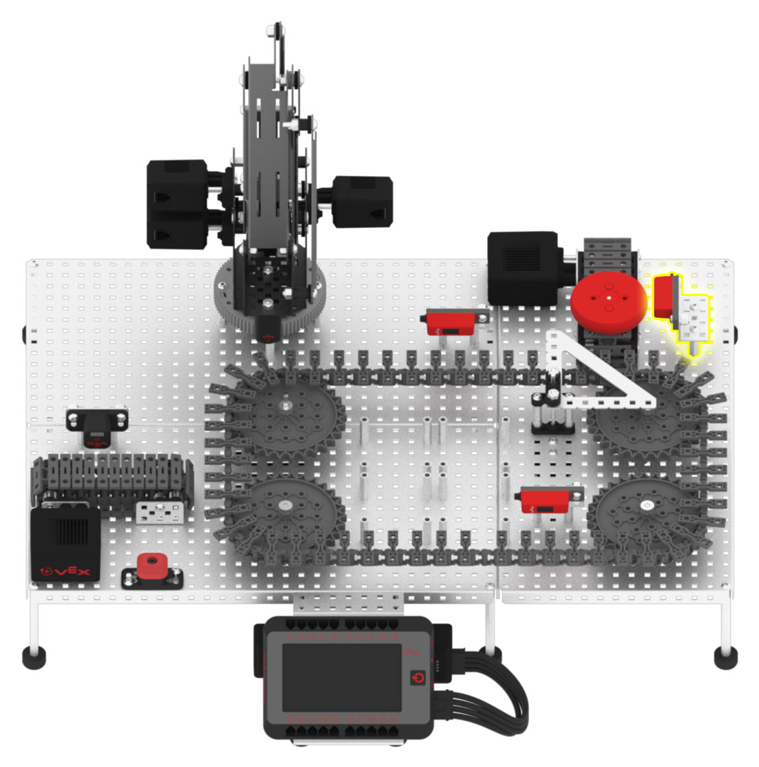

    Once the red disk is on the Exit Conveyor, it will pass in front of the Exit Sensor. When the red disk passes in front of the Exit Sensor, all conveyors will need to stop.
    The red disk will pass in front of the Exit Sensor.
  4. Add another [Comment] block and change the comment to, ‘Stop all conveyors once the disk reaches the Exit Sensor.’
