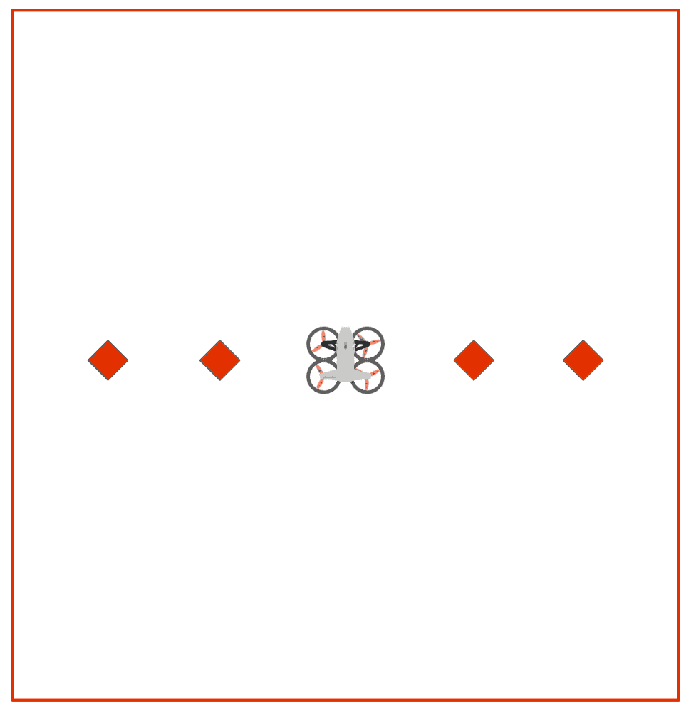

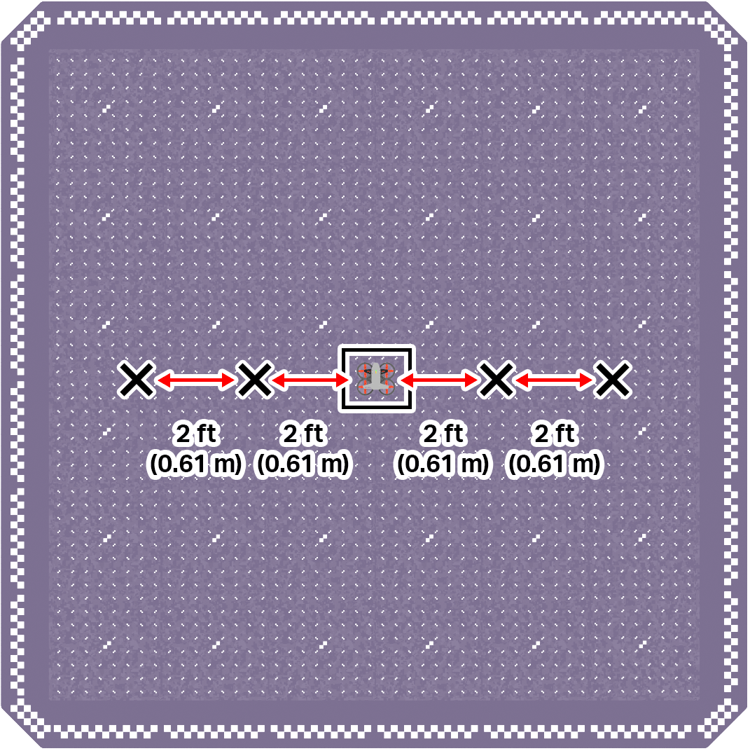

  1. Mark four locations on the ground to the left and right the drone's takeoff zone, in the center of the field.
    1. Two should be directly to the right of the drone. Each one should be 2 ft (0.61 m) apart.
    2. Two should be directly to the left of the drone. Each one should be 2 ft (0.61 m) apart.
    3. Use the image below for reference as you set up your indoor flight area.
      The VEX AIR Drone positioned in the center of a field with two red diamonds directly to the left of the drone, and two red diamonds directly to the right of the drone.
