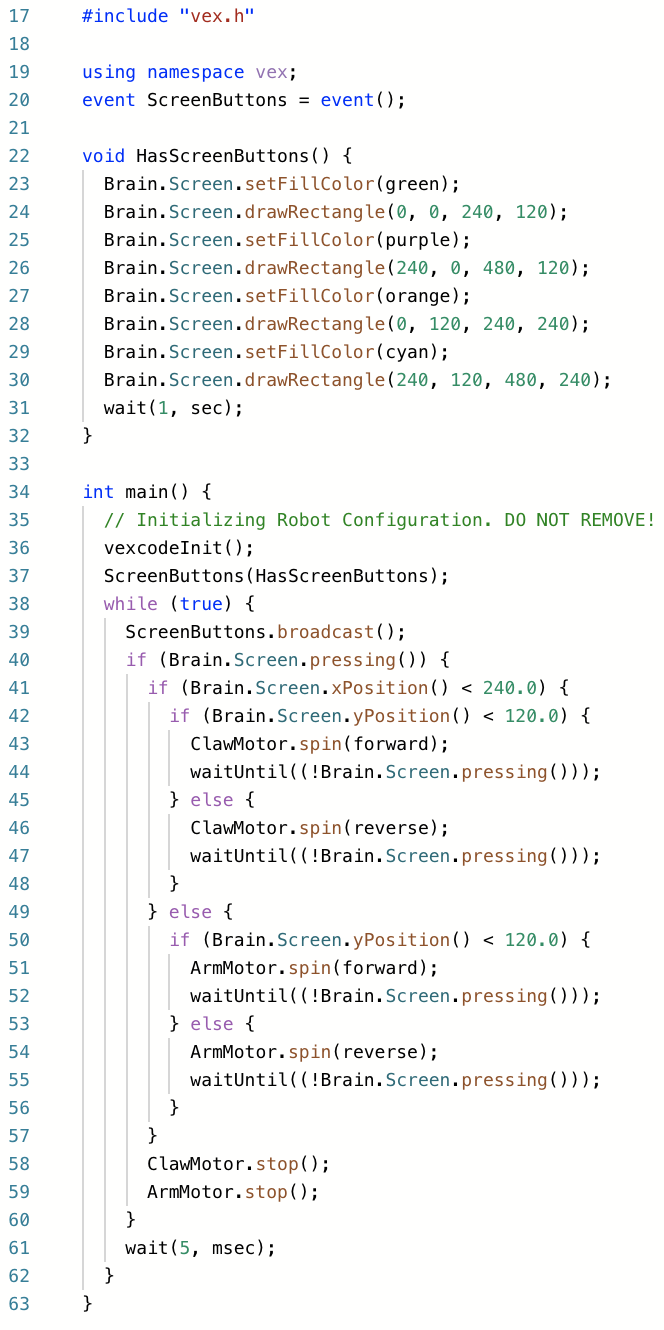

Extend Your Learning icon Extend Your Learning
In the Rethink section's User Interface Challenge, students will be asked to develop a project that creates four buttons on the screen to control the Clawbot's claw and arm. For that challenge, they are also asked to have those four buttons shown on the screen. This Extend Your Learning, like the previous page's will help to prepare them for that challenge because the challenge has four buttons to program for and this only has two.
Have students add an event to the program so that the screen draws two visible buttons when the project runs. Suggest that students use the Help feature in VEXcode V5 for information about Events , particularly the draw rectangle instruction's information. Direct students to review how the brain's screen is organized into a coordinate system based on the number of pixels when used in the draw rectangle block. They will need to understand that in order to set parameters within that block. Additionally, they will need to understand how to broadcast events. In this case, the event is drawing buttons.
Students should plan, test, and refine these changes to the project while documenting it within their engineering notebooks. For the individual engineering notebook rubric, click one of the following links (Google Doc / .docx / .pdf), or click one of the following links for team notebooks (Google Doc / .docx / .pdf).
Here is an example solution:
