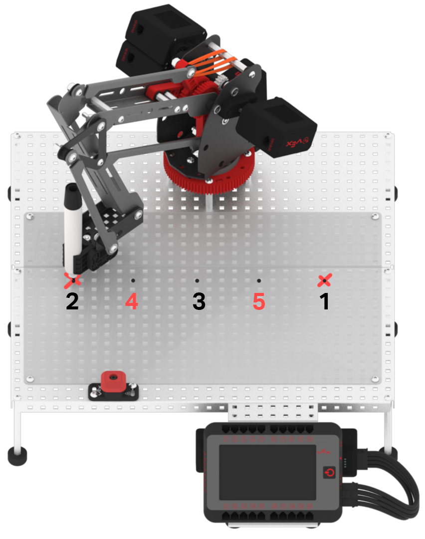

  • Use the Midpoint formula to calculate two more points, Point 4 and Point 5. Record all (x, y, z) values in your Engineering Notebook.
  • Use the (x, y, z) values for Point 1, 2 and 3 from the Play section.
    • Point 4 is calculated as the Midpoint of Point 2 and Point 3.
    • Point 5 is calculated as the Midpoint of Point 1 and Point 3.
    • Calculate and record the locations above Point 4 and Point 5.
  • Create a project in VEXcode V5 to move the arm mounted on the V5 Workcell to all five points using linear motion.
    • Note that this is the same as the Play activity, just adding two more points.
    • The project must lift the arm mounted on the V5 Workcell up after each point is drawn. The dry-erase marker should not connect any of the points.
    • Ensure that your project has the arm mounted on the V5 Workcell drawing the points in the correct order. The arm mounted on the V5 Workcell should draw Point 1, Point 5, Point 3, Point 4, then Point 2.
