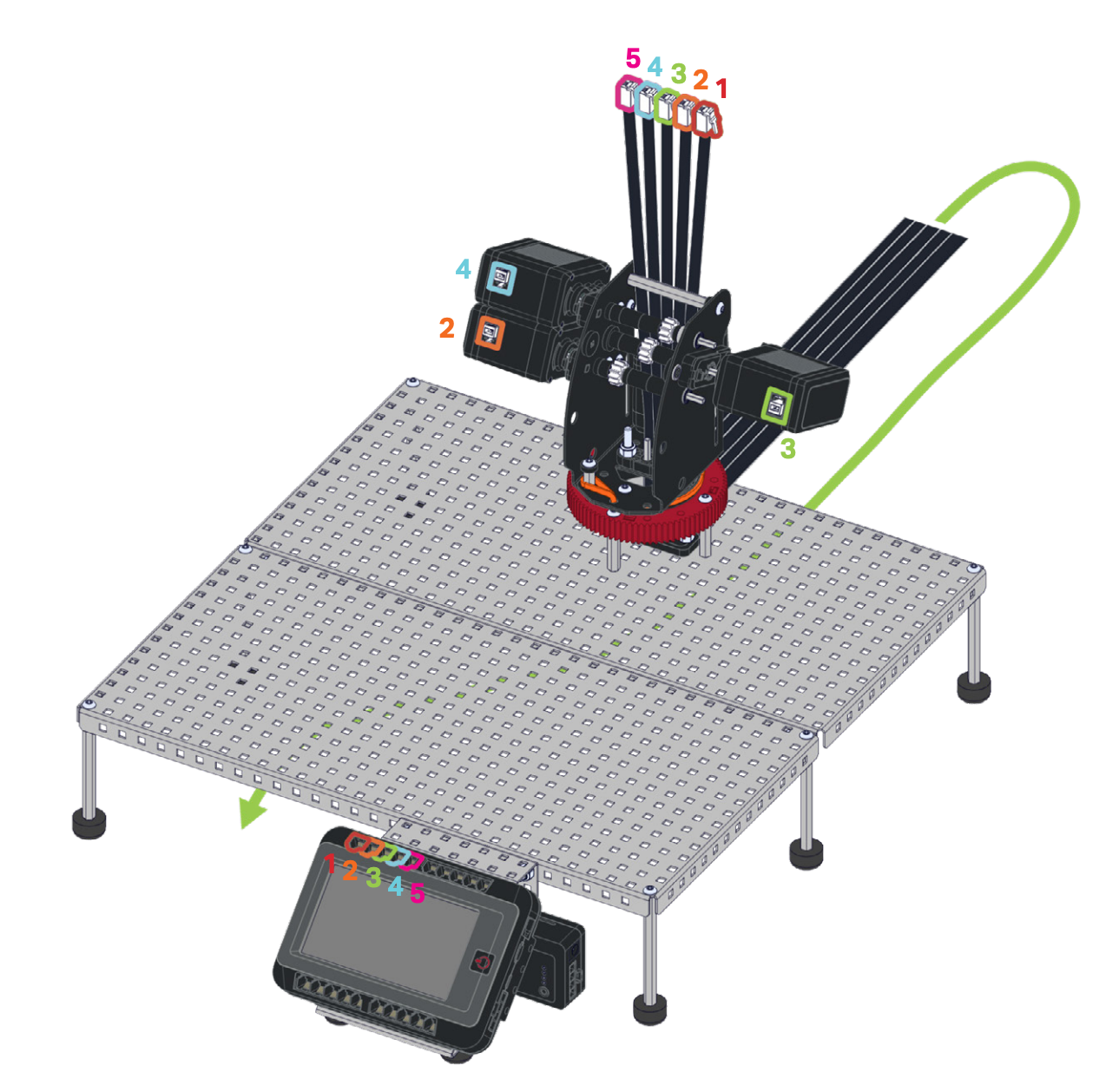

Adding the Arm
Before adding the arm back to the Workcell, ensure you know where the arm needs to be placed. This placement should be based on the positions the arm must end up in and will affect the coordinate system of the Workcell once placed.
Place the Potentiometer on the base plate at the desired location. Remember the (0, 0, 0) point of the Cartesian Coordinate System will be wherever the center of the turntable is (also where the shaft that goes into the Potentiometer), as shown in the image here.
When looking at the Potentiometer, remember the orientation. The direction of the screws on the Potentiometer will align with the positive y-axis and the direction with the 3-wire cables will align with the negative y-axis.
Attach the potentiometer to the base plate in the location that will work best for your design.
Keep in mind that this image is just an example of how attaching the potentiometer could look. Each group's Workcell design and layout may look different.
For additional support, follow steps 8-10 in the Lab 1 build instructions.
Add the base of the arm back to the Workcell. Ensure that the orientation of the base matches the desired orientation of the arm.
For additional support, follow step 33 in the Lab 1 build instructions.
Reattach all of the cables to the smart motors and sensors.
Note that you may need to use different lengths of cables than what is listed in the build instructions or you can create your own custom length smart cables. See the following page to learn more about creating custom cables.
For reference on which ports the motors should be attached to, view steps 34 and 35 of the Lab 1 build instructions.
