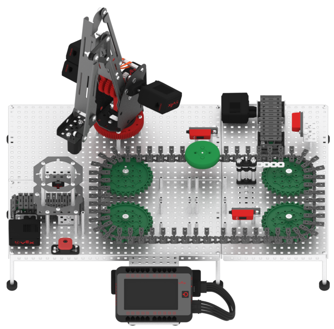

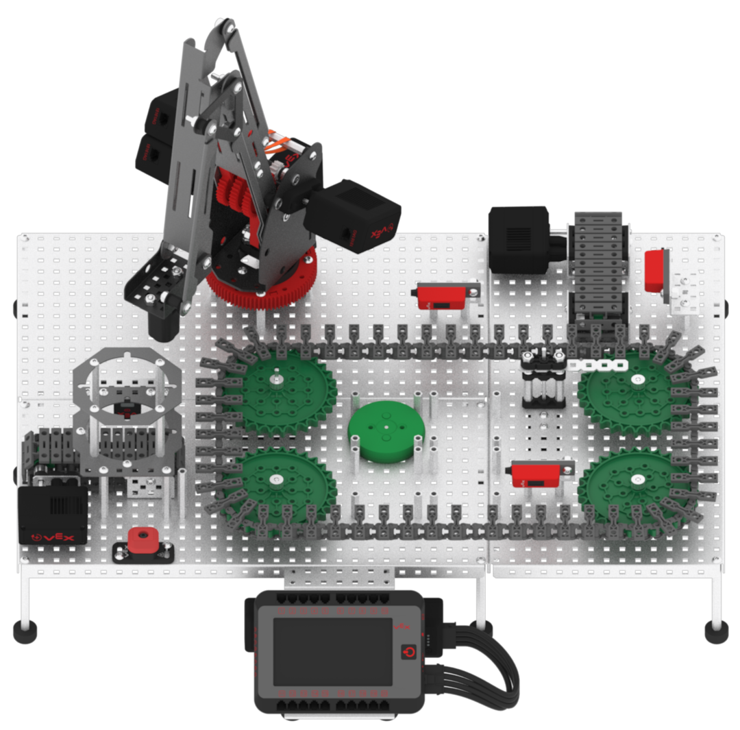

  7. Load a green disk into the Disk Feeder.
    Green Feeder
    Note: manually move the Diverter back to the starting position if it is not there already.
  8. Download and run the project.
    step 40
  9. Observe the green disk move on to the Transport Conveyor, stop in front of the Pickup Sensor, and be placed into the drop off location by the arm mounted on the V5 Workcell.
