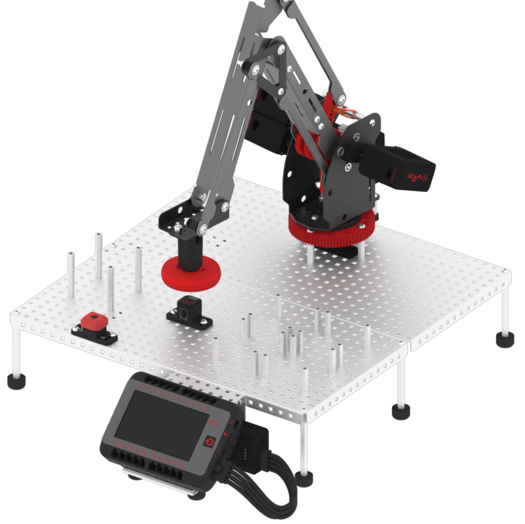

- After the arm mounted on the VEX V5 Workcell picks up a disk, it must move it above the Optical Sensor in order for the color to be detected.
- Select and drag the [Comment] block from the ‘Comments’ category in the Tool Box and attach it to the [Linear move] block. Change the comment to, ‘Move to Optical Sensor Location.’

- Select and drag the [Linear move] block from the ‘Arm’ category in the Tool Box and attach it to the [Comment] block. Set the parameters of the [Linear move] block to the (x, y, z) coordinates of the location above the Optical Sensor.
