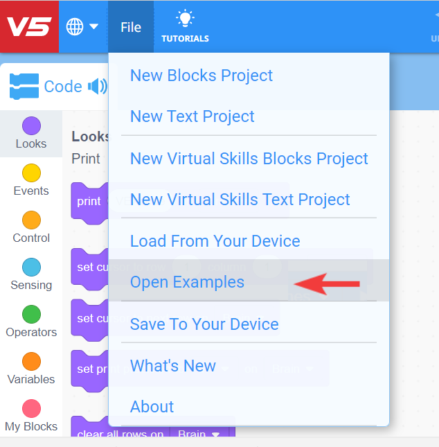

  • Open the File menu and select Open Examples.

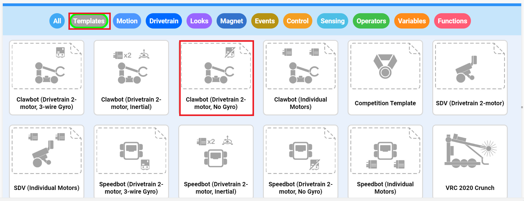

  • Select and open the Speedbot (Drivetrain 2-motor, No Gyro) template project. The template project contains the Speedbot's motor configuration. If the template is not used, your robot will not run the project correctly.

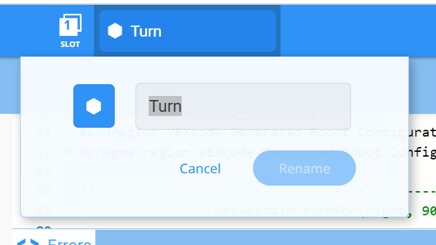

  • Since you will be working on turning the Speedbot, you will name your project Turn.
  • When finished, select Rename.
