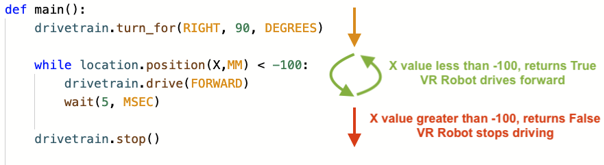

  • In this project, the VR Robot drives to the number ‘5’ on the Number Grid Map Playground. The while loop is used so that the VR Robot will continue to drive forward while the X-value is less than the X-value of the coordinate that the indicated number is on.
  • Once the X-value is greater than -100, the project moves to the next command outside the loop, which is a stop command. Since the X-value of the number ‘5’ is -100, the VR Robot will stop driving once the X-value is greater than -100.
Flow of the python project that was just run. An arrow indicates that the robot moves to the while loop once the turn right 90 degrees is completed. A cyclic arrow is next to the while loop with text that reads 'x value less than negative 100 returns True, VR Robot drives forward.' Beneath that is a red arrow with text that reads 'x value greater than negative 100, returns False. VR Robot stops driving.'

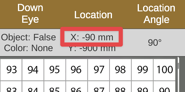

For Your Information
Notice that the value reported by the Location Sensor may not be exactly -100 millimeters (mm). Like the Distance Sensor, the comparison operators are used because of the time it takes for the VR Robot to iterate through the project and report values.
Dashboard in the Playground window zoomed in to show the reported x value of the Location sensor is negative 90 millimeters.
