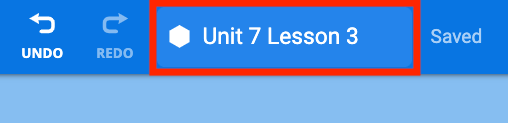

Rename the project to Unit 7 Lesson 3, and save it to your device.
The VEXcode Toolbar showing the project name which reads Unit 7 Lesson 3. The project name is highlighted with a red box.

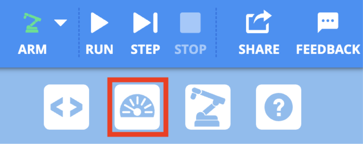

Be sure the 6-Axis Arm is connected to VEXcode.

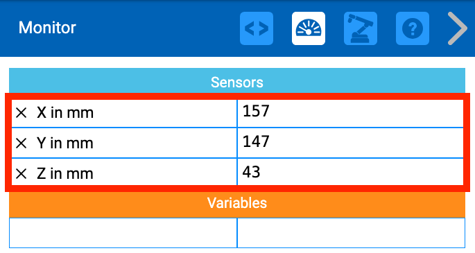

Select the Monitor icon in the Toolbar to open the Monitor.
The VEXcode Toolbar showing the project control buttons in the top right of VEXcode. Beneath the project control buttons, the Monitor Sensor button, positioned two from the left, is highlighted with a red box.

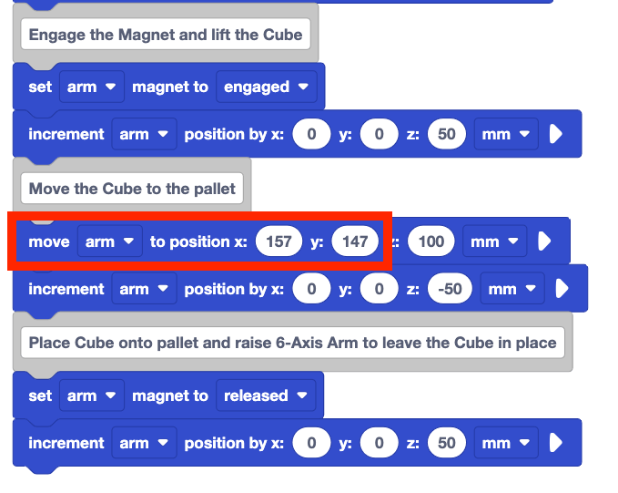

Record the x and y-coordinates from the Monitor Console in your engineering notebook. This will be the x and y-coordinates of drop off location for the Cube.
Remember that the 6-Axis Arm is going to move above the drop off location before moving the Cube down to the pallet. This means you do not need to record the z-value.
The VEXcode Monitor console showing the X, Y, and Z positions of the 6-Axis Arm in millimeters. The current positions are the following, X is 157, Y is 147, and Z is 43. Those three positions are highlighted with a red box.

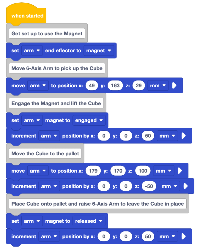

Input the x and y-coordinates of the new drop off location into you project. The z-coordinate should remain the same, so that the 6-Axis Arm stays above the drop off location.
Be sure to use your coordinates, as the ones shown here are an example, and may vary from your own recorded coordinates.
The same stack of blocks from before, but now, the move arm to position block directly beneath the Move the Cube to the pallet comment block is modified. The block now reads move arm to position x 157 y 147 z 100 mm. These modified x and y values are highlighted with a red box.

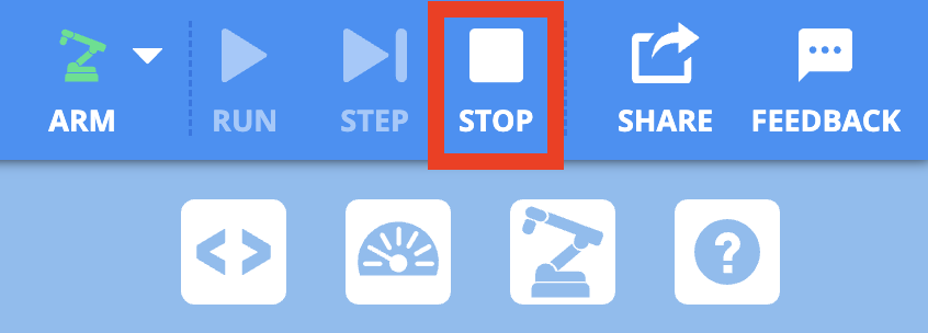

Stop the project when the 6-Axis Arm has stopped moving. Record your observations in your engineering notebook.
The VEXcode Toolbar showing the project control buttons in the top right of VEXcode. The Stop button is highlighted with a red box.

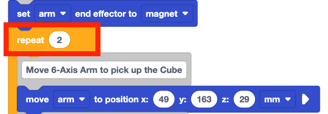

Adding a Repeat Block
Knowing that a sequence of behaviors are going to be repeated, the first strategy to try is using a Repeat block. As you learned in the previous Unit, a Repeat block is useful for repeating blocks or a stack of blocks in a project.

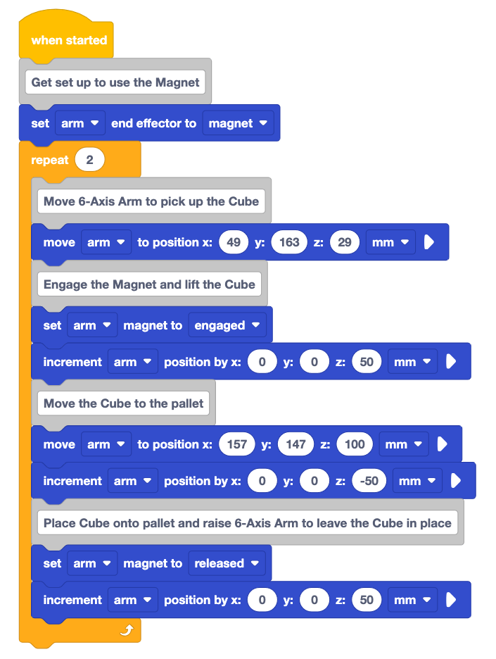

Add a Repeat block to your project beneath the Set end effector block, as shown in this video.
Video file
Drag the Move the Cube to the pallet Comment block into the Repeat block, as shown in this video. This will drag all of the subsequent blocks into the Repeat block as well.
Now, all of the blocks needed to pick up and place a Cube from the pick up location to the corner of the pallet can be repeated.
Video file
Set the parameter in the Repeat block to 2.
Since you are trying to move two Cubes to the pallet, the behaviors will be repeated two times.
The same stack of blocks from before, but now everything below the set arm end effector to magnet block is inside a repeat block. The repeat block's parameter is set to two, indicating that it will repeat all the blocks within it twice. The repeat block is highlighted with a red box.
Read the code you have built, and predict what the 6-Axis Arm will do when the project is run.
Record your prediction in your engineering notebook. You may want to sketch the path of the 6-Axis Arm, or draw where the Cubes will be placed on the pallet.
The same stack of blocks from before, showing the whole stack of blocks.

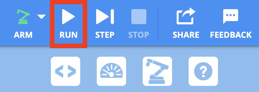

Run the project to test it. Observe the behaviors of the 6-Axis Arm when the project is run.
The VEXcode Toolbar showing the project control buttons in the top right of VEXcode. The Run button is highlighted with a red box.
Stop the project when the 6-Axis Arm finishes moving. Record your observations in your engineering notebook.

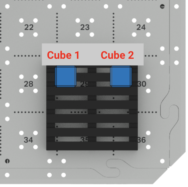

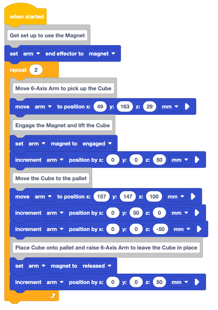

Knowing the position of the first Cube on the pallet, means that the next Cube can be placed relative to the first. You learned about relative movement in the previous Unit, and now can apply those concepts to help place the second Cube.
To reach the next corner of the pallet, the 6-Axis Arm will move in the positive direction along the y-axis. A top down view only showing the installed pallet on the CTE Tile. It shows two blue cubes, one placed on the top left corner and one on the top right corner of the pallet. A red arrow points from the top left cube to the top right cube, labeled plus y direction.
Using what is known about the size of the Cube, the offset needed to place the second Cube can be determined. The offset is the difference between the current location and the desired location of an object. On the pallet, the offset for the second Cube is the distance between the center of the first Cube and the center of the second Cube in its desired location.
Given that a Cube is 25mm wide, we can approximate that the offset is 50mm.A top down view only showing the installed pallet on the CTE Tile. It shows two blue cubes, one placed on the top left corner and one on the top right corner of the pallet. A red line is drawn between the centers of both cubes and is labeled 50 mm.

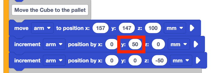

Now that you know the distance and direction of the relative movement needed, this information can be added to the project.
Add an Increment position block by dragging it from the Toolbar and in the middle of the Move the Cube to the pallet comment section of blocks, as shown in this video.
Video file
Set the y-parameter to 50. This indicates a relative movement of 50mm along the y-axis.
The stack of blocks shown before, zoomed in to the section of blocks beneath the Move the Cube to the pallet comment block. These three blocks are in order, a move arm to position x 157 y 147 z 100 mm block, an increment arm position by x 0 y 50 z 0 mm block with the y 50 position highlighted with a red box, and an increment arm position by x 0 y 0 z -50 mm block.
Read the code, and predict the behavior of the 6-Axis Arm.
Record your prediction in your engineering notebook. Do you think this project will successfully place both Cubes in the desired locations? Why or why not?
The same stack of blocks from before, showing the entire stack of blocks beneath the When started block.
Be sure the 6-Axis Arm is connected to VEXcode. Run the project to test it.
Observe the behavior of the 6-Axis Arm.
Stop the project when the 6-Axis Arm is finished moving. Record your observations in your engineering notebook.

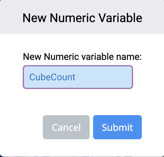

To keep track of which Cube is being moved, a variable can be created and used in the project to essentially 'count' the Cubes as they are being manipulated. A variable can be used to store information about which Cube is being moved. This information can then be used to make a decision within the project – if the 6-Axis Arm is moving the second Cube, then it should move it to the second location on the pallet.
Make a variable and name it CubeCount. Select Submit to create the variable.
You can revisit Unit 6 Lesson 2 for reminders on how to create a variable in VEXcode.
The variable naming dialog box in VEXcode. It reads New Numeric Variable at the top and inside the box reads New Numeric variable name, with the variable name called CubeCount.

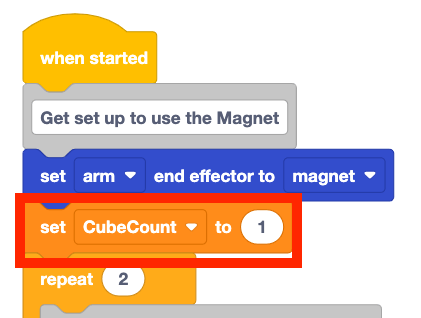

Add the Set variable block to the project above the Repeat block, as shown in this video.
Video file
Set the parameter to 1. Be sure the CubeCount variable is selected in the dropdown.
When the project is started, the first Cube will be picked up. Since the purpose of this variable is to number the Cube that is being moved, it needs to be set to '1' to begin.
The same stack of blocks as before with the set CubeCount to 1 block added to be above the repeat 2 block. This new block is highlighted with a red box.

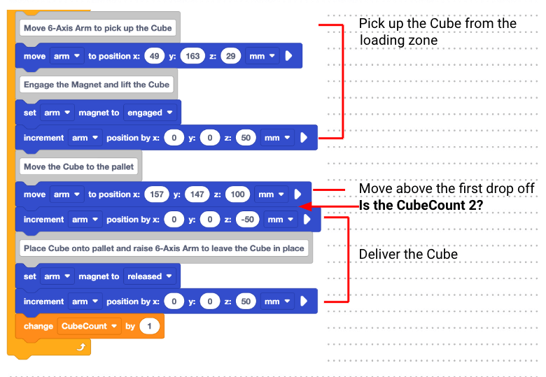

Now that the project is storing information about the number of Cubes, we can use that information to make a decision. An If then block enables us to ask a question within a project, and use information (like the value of a variable) to make a decision. An if then block with no boolean block inserted and no blocks nested inside of it.

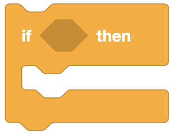

The If then block is a C block that accepts Boolean reporter blocks as a condition. A Boolean block returns a condition as either TRUE or FALSE, and fits inside any block with a hexagonal input. If the condition reports as TRUE, then the blocks within the C-block will run. If the condition reports as FALSE, the If then block will be skipped in the project.
In this instance, the condition we are looking for is for the CubeCount variable to be 2. If the CubeCount variable is 2, then the 6-Axis Arm needs to move to the second position on the pallet.
Let's think about where in the project that decision needs to be made. The project will pick up the Cube in the loading zone, then move above the drop off location. If the CubeCount is 2, then the 6-Axis Arm will need to perform an extra behavior to move to the second pallet position. The same stack of blocks from before, showing notebook lines to the right of it. A red line covers the blocks inside the Move 6-Axis Arm to pick up the Cube and Engage the Magnet and lift the Cube comment block sections that is labeled Pick up the Cube from the loading zone. A line comes off the move arm to position x 157 y 147 z 100 mm block that is labeled Move above the first drop off. A red arrow points to the section between that previous block and the increment arm position by x 0 y 0 z -50 mm that is labeled Is the CubeCount 2? That increment arm position block down to the next increment arm position block is sectioned by another red line that is labeled Deliver the Cube with the change CubeCount by 1 block at the bottom of the repeat block's loop.

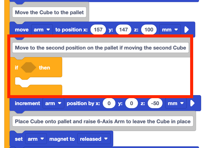

Add an If then block to the project as shown here.
The same stack of blocks as before, but now two new blocks have been inserted beneath the move arm to position x 157 y 147 z 100 mm block, where the red arrow was pointing in the previous image. These blocks are a comment block that reads Move to the second position on the pallet if moving the second Cube and an empty If then block. These two new blocks are highlighted with a red box.

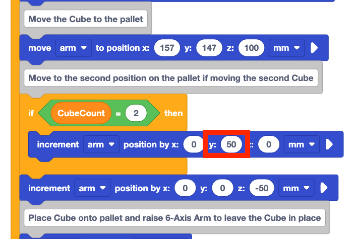

Add an Increment position block inside the C block as shown in this video.
Video file
Set the y-parameter of the Increment position block to 50.
When the condition of the If then block is met, the Increment position block inside the If then block will be executed. This means that if the CubeCount is 2, then the 6-Axis Arm will make the relative movement to the second position on the pallet.
The same stack of blocks from before with the added blocks under the Move to the second position on the pallet if moving the second Cube comment block being an if CubeCount equals 2 then block. Inside that if then block is an increment arm position by x 0 y 50 z 0 mm block. The y 50 position is highlighted with a red box.

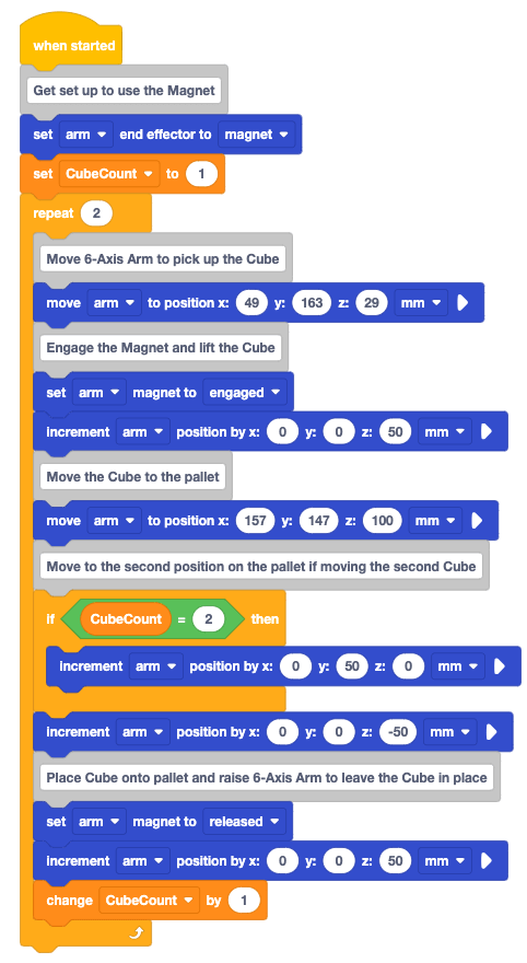

Read the code and predict what the 6-Axis Arm will do when the project is run.
The same stack of blocks, now showing the complete stack of blocks with no highlighted sections.
Observe the behavior of the 6-Axis Arm as the project runs.
Stop the project when the 6-Axis Arm has finished moving. Record your observations in your engineering notebook.
Did the 6-Axis Arm move as you predicted? Did both Cubes get moved to the pallet as intended? Why or why not?

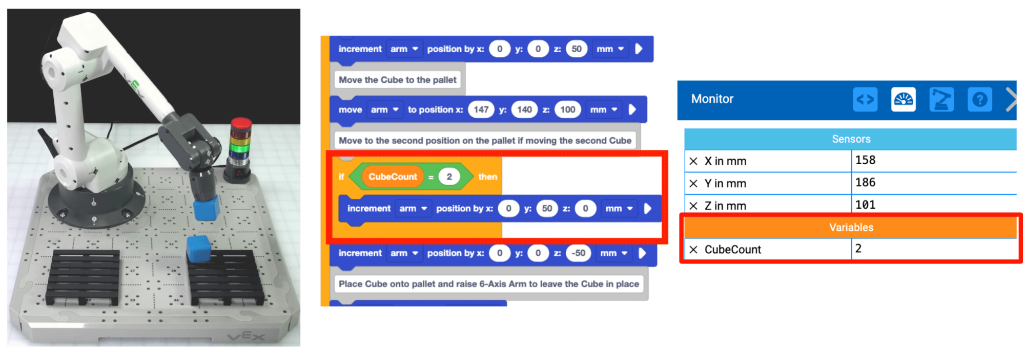

For Your Information

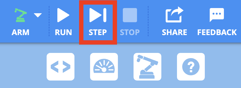

You may want to run the project multiple times, so that you can pay attention to the blocks that are running as the 6-Axis Arm is moving. Look for the highlight around the blocks as they are run in the project, to help you better understand when the If then block is run. You can also use the Step feature to run the project one block at a time, to help you see the project flow with the If then block more clearly. The VEXcode Toolbar showing the project control buttons in the top right of VEXcode. The Step button is highlighted with a red box.
Remember that you can add a variable to the Monitor, to help see the CubeCount value as the project is running. To add a variable to the Monitor, drag the variable into the Monitor icon in the Workspace, as shown in this video. As you run the project, be sure to watch the variable in the Monitor, to help you see the connection between the variable value and the project flow.

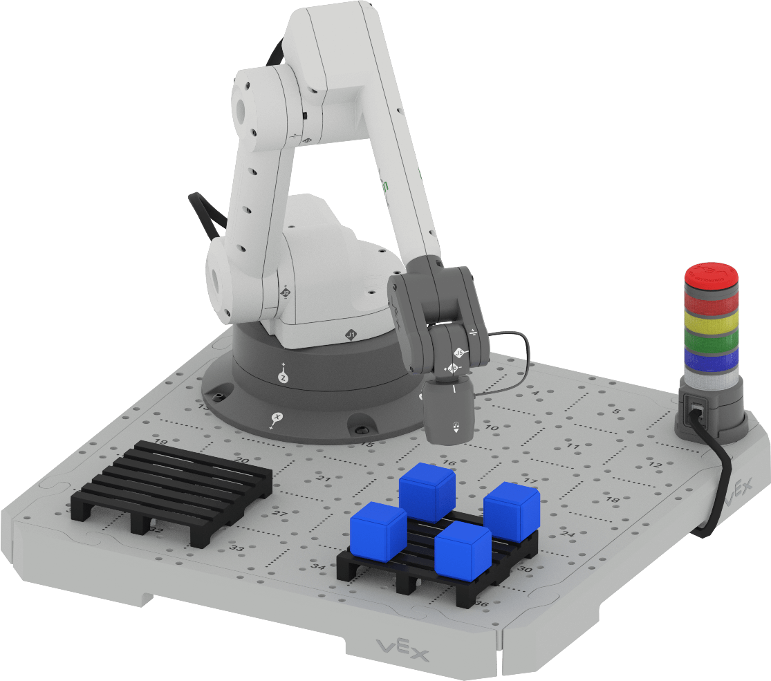

Activity
Now that you have moved two Cubes from the loading zone to the pallet, you will practice these skills. In this activity, you will build on your project from this Lesson to code the 6-Axis Arm move four Cubes to the pallet.
An angled view of the 6-Axis Arm equipped with the Magnet Pickup Tool and the CTE tile, showing 4 blue cubes placed on each corner of one of an installed pallet.
Activity: Code the 6-Axis Arm to place four Cubes on one pallet.
  1. Plan how you will build onto your project to code the 6-Axis Arm to pick up the additional Cube from the loading zone and place it on the pallet with your group. Be sure that you are all agreed on your approach before you begin editing the project.
