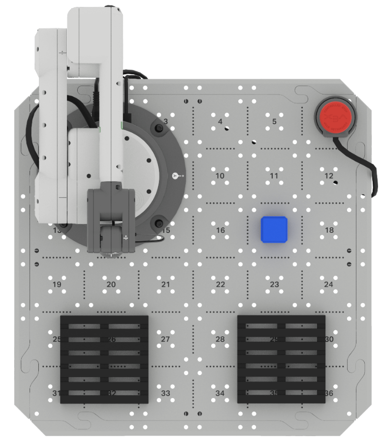

Setup: Place one Cube at the loading zone. The loading zone is located at Tile location 17.
Top down view of a 6-Axis Arm on the CTE Tile with two pallets installed. A blue cube is placed on position 17 on the CTE Tile.
Activity: Create a VEXcode project for the 6-Axis Arm to use the Magnet to move eight Cubes from the loading zone to the two pallets.
