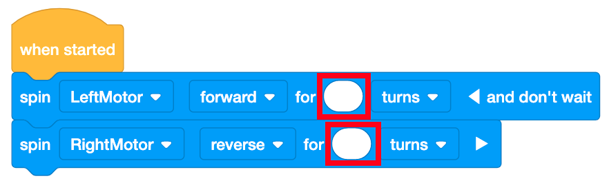

    • Once the Example Project is open, students will need to change the direction of the right motor to reverse, by selecting the dropdown in the [Spin for] block.  Watch the video below to see how to change the parameter to make the robot turn in this project. The direction dropdown in the second [Spin for] block is opened by clicking on it and the direction is changed from ‘forward’ to ‘reverse’.
      Video file
    • Have students name their project as Parade Float Turn and save it to their device. See this section of articles for device-specific steps to save a VEXcode GO project.
    • When they are ready, students will input their solution into the parameters of the [Spin for] blocks.
    VEXcode GO project with a When started block and two attached Spin for blocks, with the distance parameters blank. The project reads When started, Spin left motor forward for blank turns and don't wait; Spin right motor reverse for blank turns.
    Input Solutions into the Parameters to Test

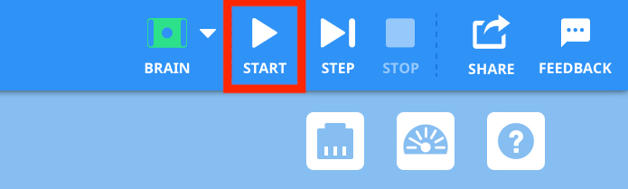

    • Once students have input their solutions, select 'Start' in VEXcode GO to test the project.
    The Start button in the Toolbar of VEXcode GO, highlighted with a red box. The Start button is between a green Brain icon and the Step button.
    Select 'Start' to test project
    • Students will need to select the 'Stop' button in the VEXcode GO Toolbar to stop the project.

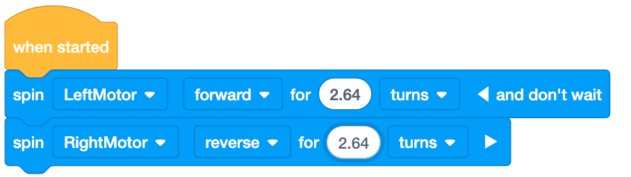

    There may be variations on the solution based on the units of measurement used, or due to variations when rounding measurements. The following is one example of a solution.
    VEXcode GO project with a When started block and two attached Spin for blocks. The blocks read when started, spin left motor forward for 2.64 turns and don't wait; spin right motor reverse for 2.64 turns.
    Possible Solution

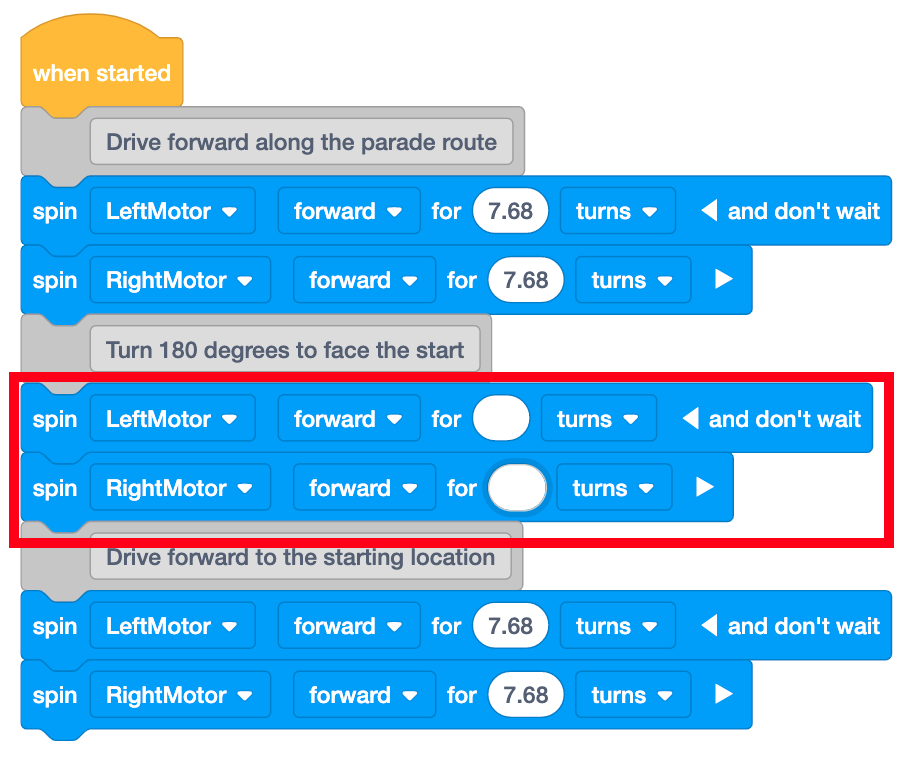

Part 2 - Step by Step
  1. InstructInstruct students that they will be applying what they learned in Play Part 1 to have their robot make a 180 degree turn, instead of a 360 degree turn, using the [Spin for] blocks in order to complete a parade route. They will also be using use their solutions from Lab 4 to have the robot drive forward the correct distance in the parade route.

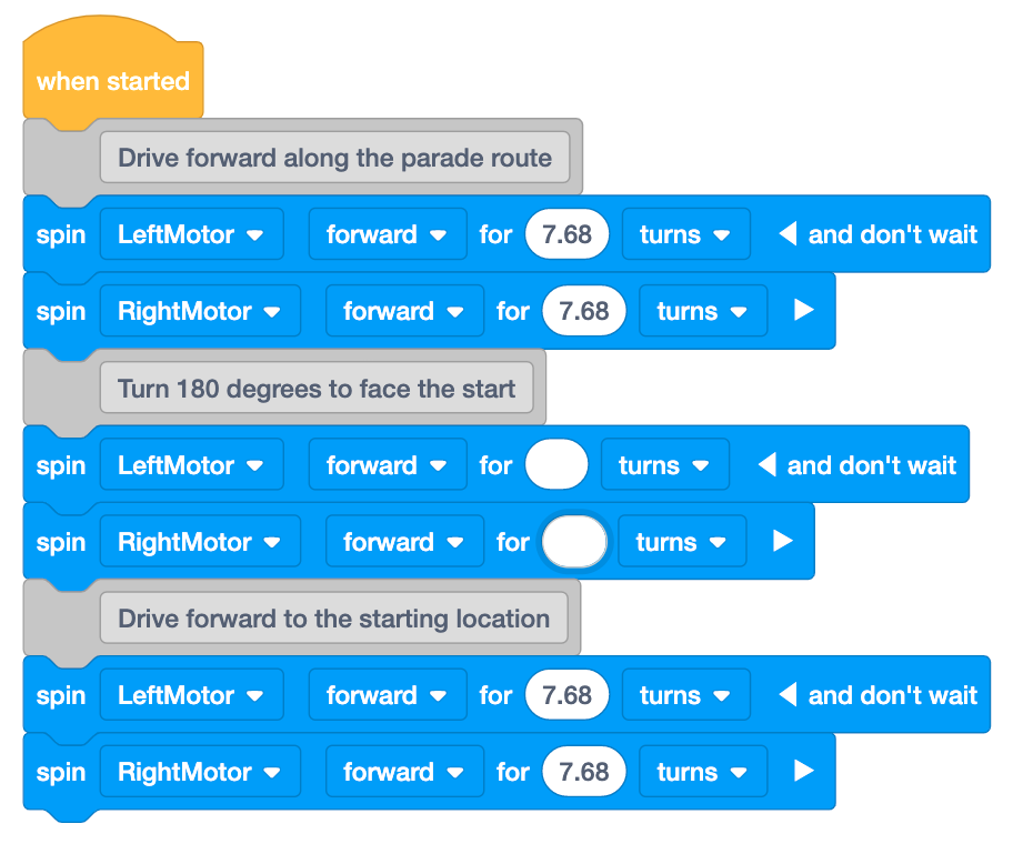

    VEXcode GO project with partially filled in parameters. The project begins with a when started block then has three sections of a comment paired with two Spin for blocks. The first section's comment reads Drive forward along the parade route; then spin left motor forward for 7.68 turns and don't wait; Spin right motor forward for 7.68 turns. The second section's comment reads Turn 180 degrees to face the start; then spin Left motor forward for blank turns and don't wait; spin right motor forward for blank turns. The third section's comment reads Drive forward to the starting location; then spin left motor forward for 7.68 turns and don't wait; spin right motor forward for 7.86 turns.
    The animation below shows how the robot should move as it completes the parade route: drive forward for 48 inches, (122 cm), turn for 180 degrees, then drive forward for 48 inches, (122 cm) to return to the start. This is using the code template above. In the animation the Code Base drives straight across five connected tiles, and when it reaches the end it turns 180 to the right and drives back to the start.
    Video file
  2. ModelModel for students how to get started with their projects in VEXcode GO.
    • Begin by having students open the Parade Route template.
      • Please note that [Comment] blocks are included to describe each section of the project. If you want to learn more about comments in VEXcode GO, see this article.
      • Also note that the first and last set of parameters have been populated with values based on solutions from Lab 4 to drive the robot 48 inches (122 cm), the length of the parade route.  These values may be slightly different from student solutions in Lab 4 due to slight variations in rounding measurements.
    Parade Route Template
    • Students will need to calculate the number of wheel turns needed to make a 180 degree turn and input those values into the highlighted blocks.
    The same VEXcode GO project from before with the two Spin for blocks beneath the Comment to 'Turn 180 degrees to face the start' highlighted in a red box.
    Input wheel turns needed to make the 180 degree turn

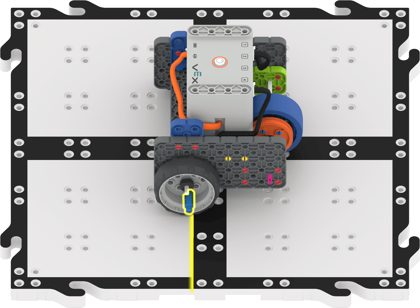

    • First, show them how to place their robot at the starting as shown in the image below.  Use the Blue Standoff on the wheel to help align the center of the wheel with the front edge of the starting line.
    Code Base Robot with Blue Standoff on the wheel lined up with the front edge of the black line bisecting a VEX GO Tile to show how to position the robot on the parade route.
    Use the Blue Standoff to help align the wheel axle and the front of the starting line

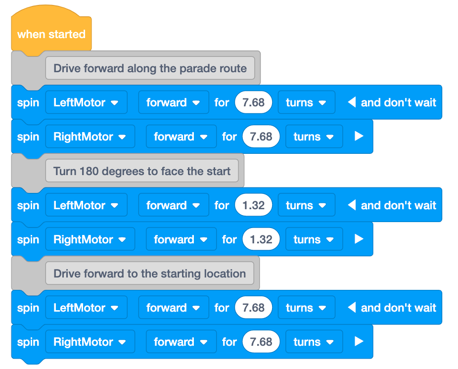

    There may be variations on the solution based on the units of measurement used, or due to slight variations when rounding measurements. The following is one example of a solution.
    The same VEXcode GO project as before with all parameters filled in. The first section's comment reads Drive forward along the parade route; then spin left motor forward for 7.68 turns and don't wait; Spin right motor forward for 7.68 turns. The second section's comment reads Turn 180 degrees to face the start; then spin Left motor forward for 1.32 turns and don't wait; spin right motor reverse for 1.32 turns. The third section's comment reads Drive forward to the starting location; then spin left motor forward for 7.68 turns and don't wait; spin right motor forward for 7.86 turns.
    Possible Lab 5 Solution
