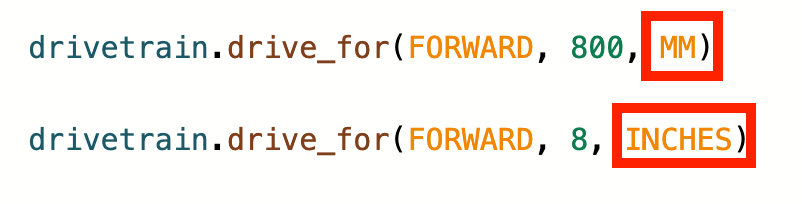

The drive_for command can accept both whole numbers (integers) and decimals (floats). The units can also be changed from millimeters (mm) to inches.

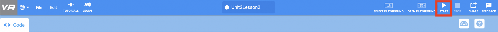

- Start the project.
The VR Robot will collide with the center castle and knock parts of it over.
- Select the “Reset” button to reset the Playground.
