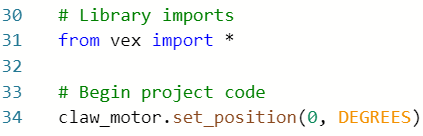

claw to open 1
  • Write the ClawMotor.setPosition(); instruction as shown above in the programming area to set the starting position for the claw.
