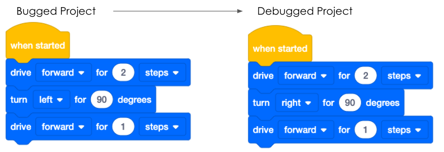

  • Students can build the same projects using the Drivetrain blocks in VEXcode 123. To fix the bug in the project, they can adjust the parameters of the blocks, like the example shown here.A Turn for VEXcode 123 block with the direction parameter open and left selected. The block reads Turn left for 90 degrees.
  • To recreate the projects for Play Part 1 of Lab 1, the VEXcode 123 projects could look like this:A side by side image of the Bugged and Debugged Project. The bugged project reads When started, drive forward for 2 steps, turn left for 90 degrees, drive forward for 1 step. The Debugged project reads When started, drive forward for 2 steps, turn right for 90 degrees, drive forward for 1 step.

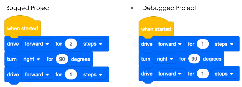

  • To recreate the projects for Play Part 2 of Lab 1 and Play Part 1 of Lab 2, the VEXcode 123 projects could look like this:A side by side image of the bugged and debugged projects. To the left, the bugged project reads When started, drive forward for 2 steps, turn right for 90 degrees, drive forward for 1 step. To the right, the debugged project reads When started, drive forward for 1 step, turn right for 90 degrees, drive forward for 1 step.

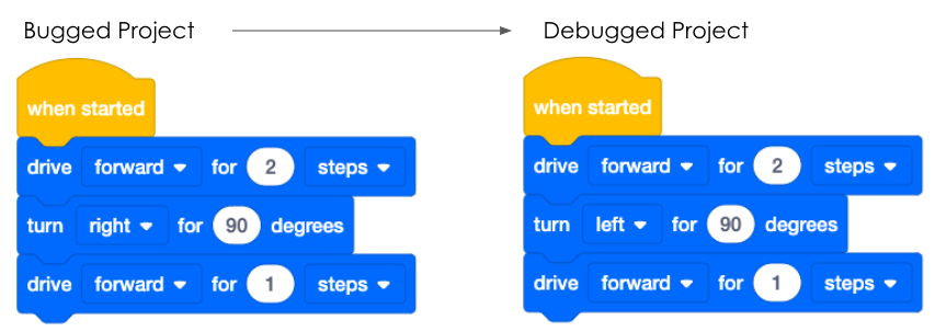

  • In Lab 2, students will use the Step feature as part of the debugging process, to help them more easily find a bug in their project. To learn more about stepping through a project in VEXcode 123, see this STEM Library article. To recreate the projects for Play Part 2 of Lab 2, the VEXcode 123 projects could look like this: A side by side image of the bugged and debugged projects. To the left, the bugged project reads When started, drive forward for 2 steps, turn right for 90 degrees, drive forward for 1 step. To the right, the debugged project reads When started, drive forward for 2 steps, turn left for 90 degrees, drive forward for 1 step.

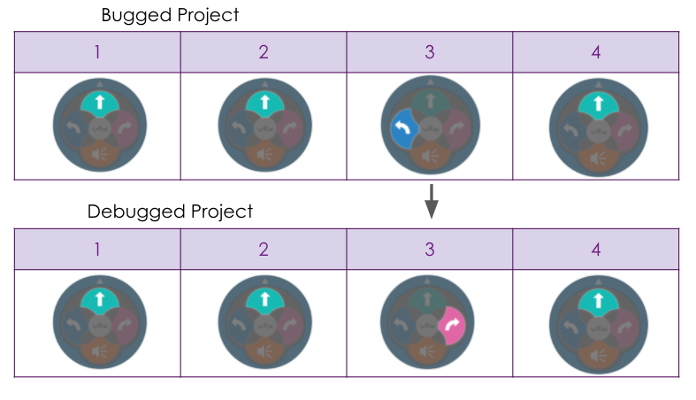

  • To recreate the projects for Play Part 1 of Lab 1 with Touch buttons, the sequences could look like this: Two touch button sequences are shown one above the other in a table, representing the bugged project on top and the debugged project below. The bugged project shows a sequence of Drive, Drive, Left, Drive. The debugged project has a different 3rd button press, to be Drive, Drive, Right, Drive.

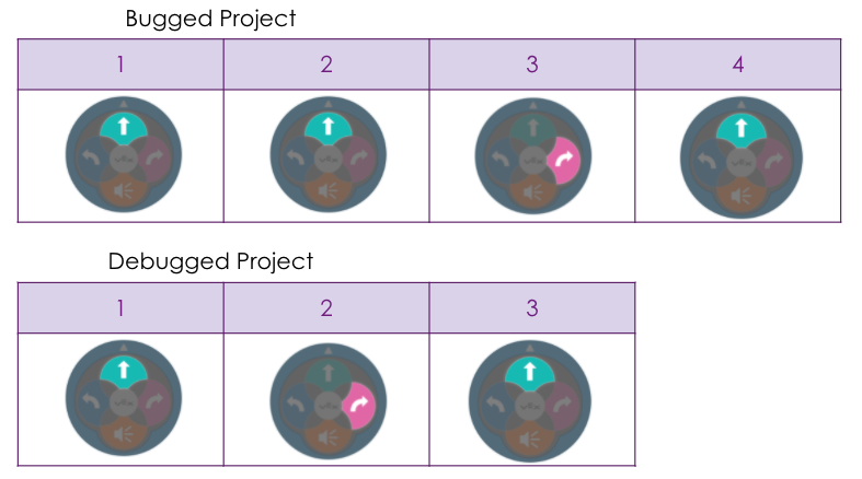

  • To recreate the projects for Play Part 2 of Lab 1 and Play Part 1 of Lab 2 with Touch buttons, the sequences could look like this: Two touch button sequences are shown one above the other in a table, representing the bugged project on top and the debugged project below. The bugged project shows a sequence of Drive, Drive, Right, Drive. The debugged project has only 3 button presses - Drive, Right, Drive.

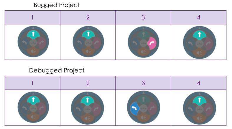

  • To recreate the projects for Play Part 2 of Lab 2 with Touch buttons, the sequences could look like this: Two touch button sequences are shown one above the other in a table, representing the bugged project on top and the debugged project below. The bugged project shows a sequence of Drive, Drive, Right, Drive. The debugged project has a different 3rd button press, to be Drive, Drive, Left, Drive.
