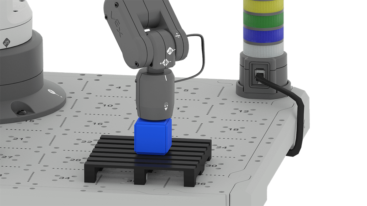

You will practice these skills for yourself in the Activity at the end of this Lesson. An angled view of the 6-Axis Robotic Arm with the Magnet Pickup Tool. The tip of the tool is touching a blue cube that is on a pallet.

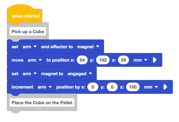

Once you have created and documented your plan, building and testing a project becomes much more efficient. In the next video, you will see how to implement part of the plan to build a successful VEXcode project.
In the video, you learned how to attach a VEXcode block to each behavior you documented in your plan, and then to enter any needed parameters. You learned the importance of testing each behavior as you build your project, so you can make needed changes to your code incrementally, rather than waiting until the entire project is built. This walked through the creation and testing of the first section of the plan to pick up a Cube from the loading zone.
A stack of blocks that start with a when started block. Underneath it is the following in order, a comment block reading pick up a cube, a set arm end effector to magnet block, a move arm to position x 54 y 162 z 29 mm block, a set arm magnet to engaged block, an increment arm position by x 0 y 0 z 100 mm, and a comment block that reads place the cube on the pallet.
