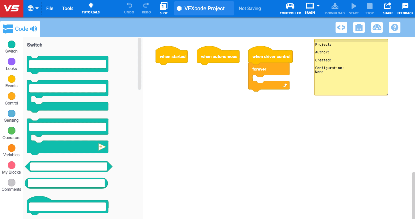

The Competition Template accounts for the three main components of a match:
- Pre-Auton / Set Up Mode: Here the team can code actions such as calibrating a gyro, setting variables, or other device settings. These blocks will run immediately when the program is started, before the autonomous portion of the match begins.
- Autonomous Mode: The first 15 seconds of a match is the autonomous period. Here, your robot performs coded behaviors, and driver control is disabled. You can earn an extra point based on your robot's ability to score in this part of the match.
- User Control Mode: The remaining 1 minute 45 seconds is where you drive your robot in the match. Here your robot runs the code that allows the driver to control the robot during the competition.
