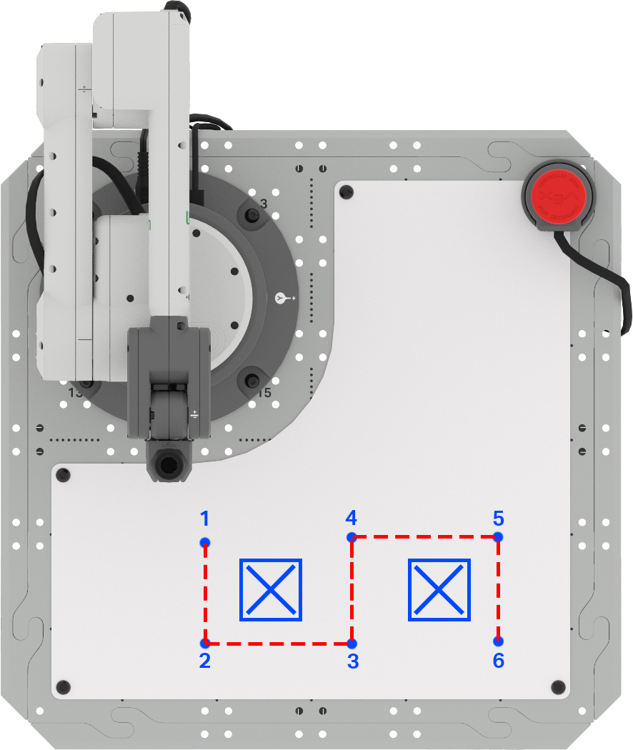

Begin by setting up your space with two "keep out" areas marked on the Whiteboard Attachment with a whiteboard marker. These should be roughly the size of a Cube.
Sketch this layout in your engineering notebook.

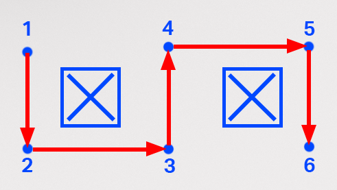

Your 6-Axis Arm will need to draw a line to follow the path provided here. Document the path in your engineering notebook.

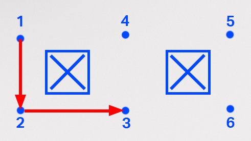

Label each waypoint needed on your Whiteboard. Document these waypoints in your engineering notebook.
In the next step, you will need to determine the (x, y, z) coordinates of each waypoint. This can be done using the formula from Lesson 2, or you can use the Monitor Console to collect each of these coordinates.

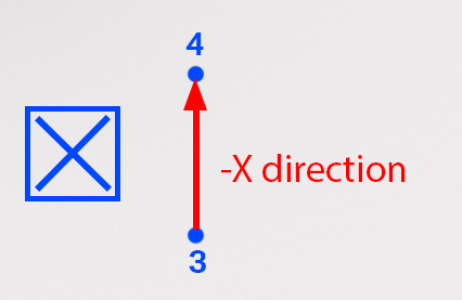

When using the formula to calculate the unknown coordinates of a waypoint, the direction the 6-Axis Arm needs to travel along an axis is important. If the 6-Axis Arm will move in the positive x or y direction, the value of ∆x or ∆y will be positive. If the 6-Axis Arm will move in the negative x or y direction, the value of ∆x or ∆y will be negative.
For instance, when moving from waypoint 3 to waypoint 4, the 6-Axis Arm will move along the x-axis in the negative direction.
When using the formula, the value for ∆x will be negative. In this example, the x-coordinate of point 3 is 195mm, and the distance between points 3 and 4 was measured to be 105mm. Using the formula, we can calculate the x-coordinate of point 4 to be 90mm, as shown here.

The 6-Axis Arm should move from waypoint 1, through waypoints 2 through 5, and end at waypoint 6. If it does not, go back and check the coordinates you put into the project. Be sure the x, y, and z-parameters match the coordinates you gathered in your engineering notebook. Run the project again to test it.
